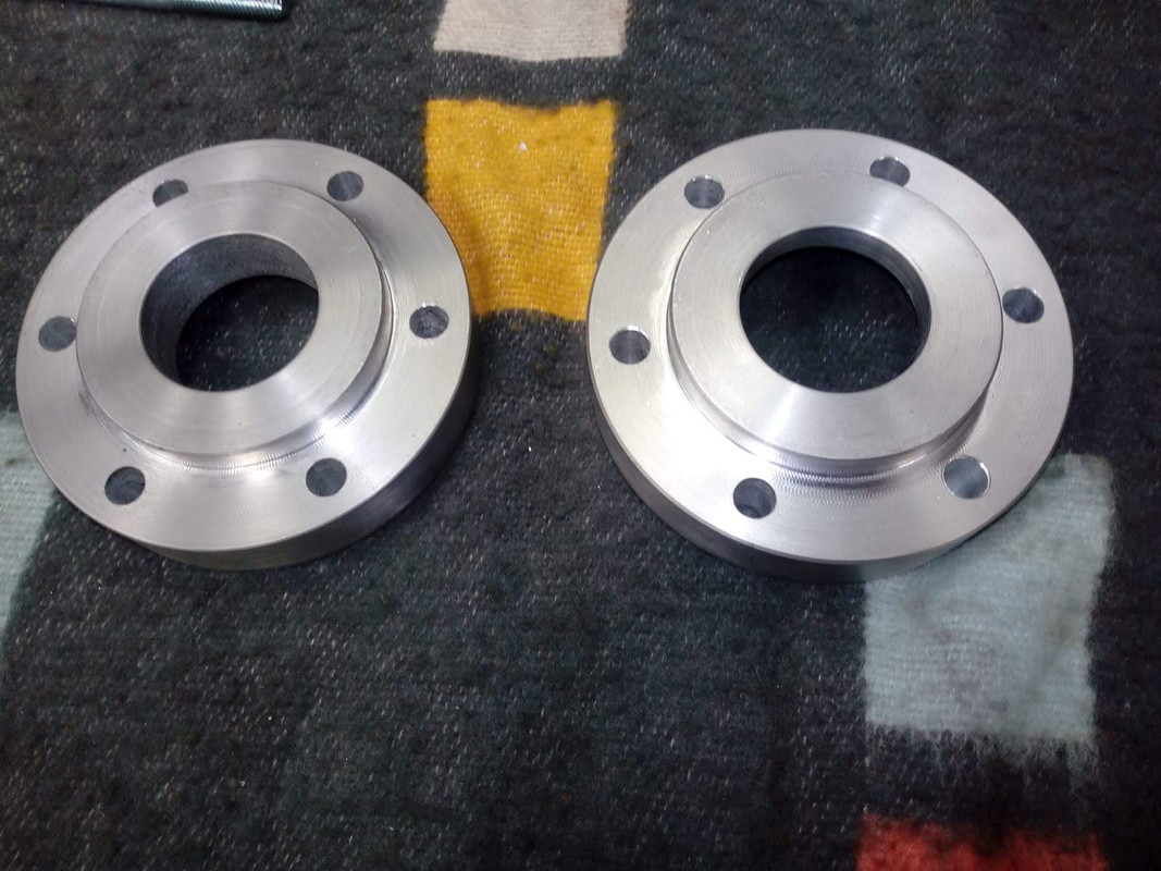

These rings fall over the original hub without the speedo device
The discs have a offset of 10mm because if else you dont have enough material to fit over the hub

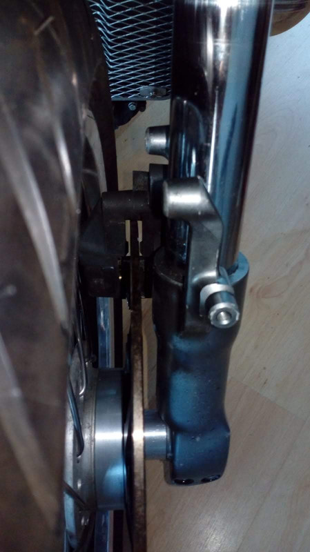

I used the original wheel hub than brand new spokes and a smaller and wider 17"' front wheel
the clearance from the spokes to the brake calliper is 3 mm
